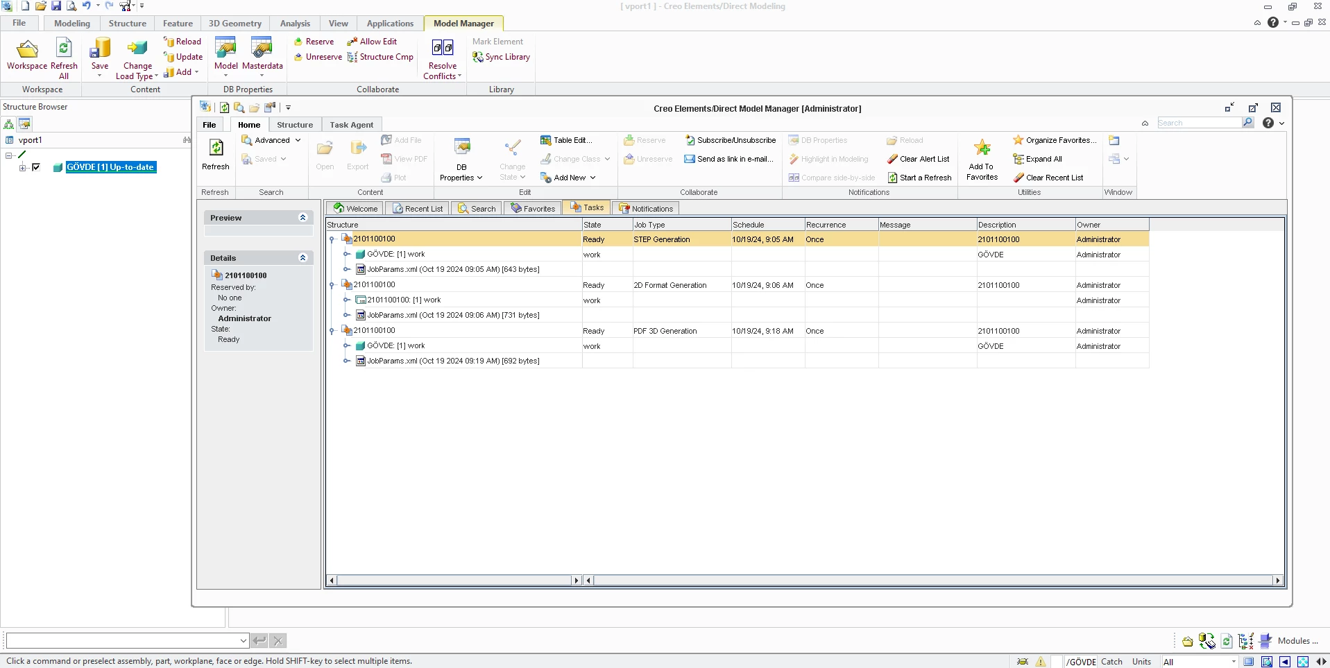

I have installed Task Manager on top of Model Manager, and everything seems to be working fine.
I am a beginner in this area.
I have assigned 3 tasks to the Task Manager, and I would like to know how I can see if these tasks have been completed.
For example, where might it have saved the step conversion job once it is completed?
Thanks.

Hello SE_10539318
After you generated a native, standard or viewing format, the results are available from the attachments. Ex: from a Model you order Task Agent to generate a STEP. After successful task completion the STEP file will be available from the model attachment (DB Properties, Attachments).
