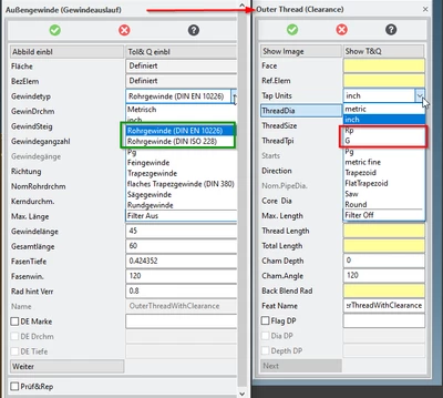

adjust the thread tables differences in CED/OSM -Machining between english and german
The German table contains a specification of the standard in the name, the English table does not.
This regularly causes discussions.

    Creo Elements/Direct Modeling (x64-edition) Revision 20.3.3.0

    On my opinion, according to your screenshots, both German and English are not precise enough because two designations are missing, R and Rc.
    ISO 228: Pipe threads where pressure-tight joints are not made on the threads
    Example: G 1/2 for internal and external thread.
    EN 10226-1: Pipe threads where pressure tight joints are made on the threads - Part 1 : taper external threads and parallel internal threads
    Examples:
    Taper external thread R 1/2
    Parallel internal thread Rp 1/2
    EN 10226-2: Pipe threads where pressure tight joints are made on the threads - Part 2 : taper external threads and taper internal threads
    Examples:
    Taper internal thread Rc 1/2
    You are right that it is not clear.
    I recommend you to post an idea on https://community.ptc.com/t5/Creo-Elements-Direct-Ideas/idb-p/creoelementsdirectideas
    To avoid any confusion, the name in the tables (German, or English, or other) should be :
    G  (ISO228-1)
    R  (EN 10226-1)
    Rp  (EN 10226-1)
    Rc  (EN 10226-1)
    Not recommended to put the national prefix DIN, BS, NF, ... Based on my own experience, this is confusing for non European Union users.
