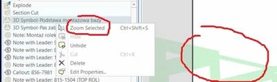

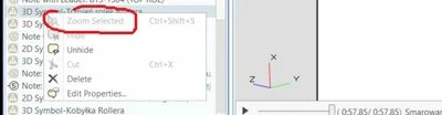

I have several animations in a sequence plus some illustrations in one c3di file. Everything was working fine untill at one point I saved the file and opened it (I didn't even touch animations today, they were made yesterday). I was using symbols and callouts that I previously used in the sequence animations. After I opened Illustrate half the symbols/notes were gone from my freshly done illustration set. Not from the Figure Content though. However the figure content looks like that:
The top SS shows a right-click menu of a properly working callout/symbol. The bottom one shows a broken one.
