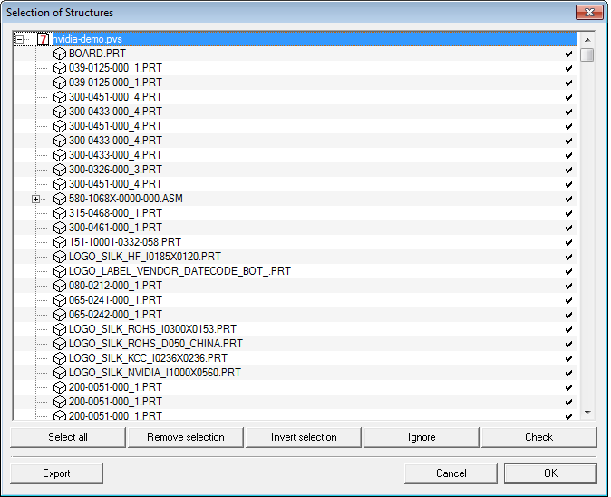

Can you check "Selection of Structures" when importing assembly?
March 26, 2014
Yes Vlad all structures are checked for import. Also tested this on multiple computers and achieved the same error.
