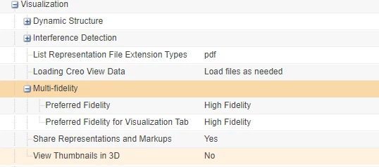

I've got the same issue but just don't have the time to troubleshoot and write a case with PTC right now.  My version is WC12.0.2.18 with Creo View 8.  Our workers are outputing creo view data from a Creo 9.0.6 worker.  (Looking to upgrade to Creo View 11 in 1Q2025.)  The pattern that I see is that when I open the representation from a CAD object it opens fine...but when I go to that corresponding representation from the WTpart page, I get this issue of red dot on objects in tree...and like you it is random.  I am also testing the mutli-fidelity publishing and trying to open the "lo resolution" object into Creo View and seeing this.  I don't have confirmation or time...but don't think I see this when opening the high fidelity rep.  So my guess is opening the lo fidelity rep from a wtpart object at this time is the scenario for me.
Below is the image showing the settings for mutli-fidelity to reference. I wonder what rep you are loading?

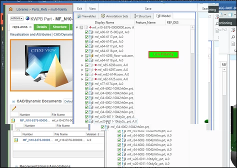

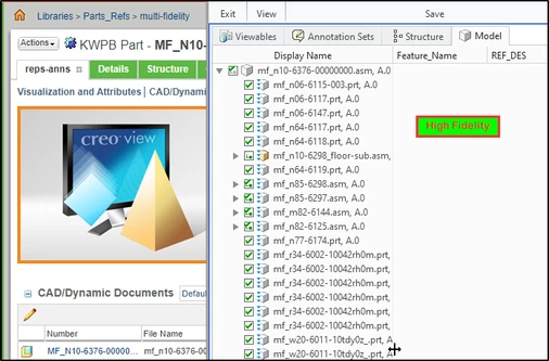

For Reference, here are the side-by-side pictures of high fidelity versus low fidelity on a positioning assembly published structure.  I'm guessing this is the icon you are seeing.  All I have to do is change the Fidelity to high to repair it.  In my case, I am seeing the geometry of the objects so really don't know what the icon is trying to tell me.
