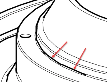

I am creating a 2D illustration from a 3D model in Creo Illustrate 10.1, but I am not satisfied with the result.
Most of the lines are smooth and clean, but some appear straight, making curved lines look “jagged”—even though the surfaces are smoothly contoured.

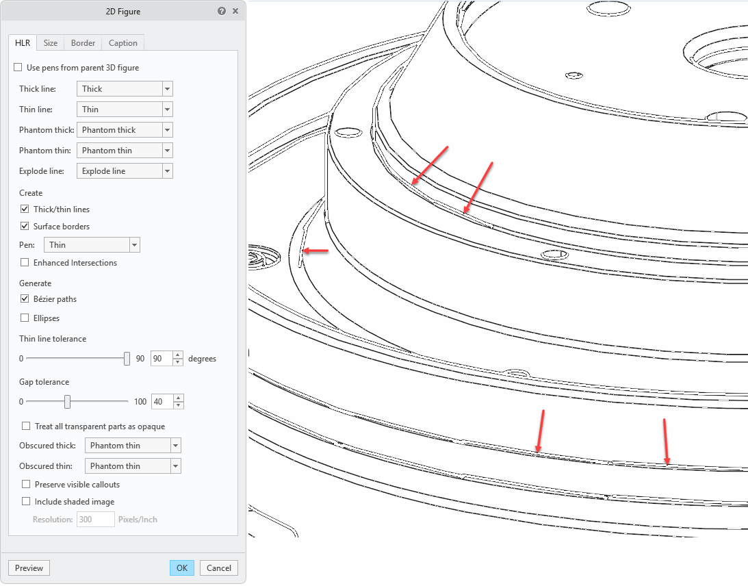

To get the desired result, I usually remove all the "jagged" lines manually. Is there any way to prevent this? I have tried various settings for 2D figures, but nothing helps.
See the attached image. The red arrows point to the "jagged" lines.

There have been many improvements to the HLR quality over the last few releases of PTC Illustrate, so I would suggest trying a later release (ideally the recent 2027 release) as this will likely give you improved line quality.

Ok. Thanks for the answer. I guess I’ll have to try a newer version of the software. So, I haven't missed a setting or anything like that; this is simply a limitation of the version of Creo Illustrate I’m using.
agarland
October 6, 2026
Without having the data to investigate properly it’s hard to say but given the improvements that have gone into the last few releases, I think trying a newer version is the best first step.
There are no settings to try to improve this particular issue, no.
