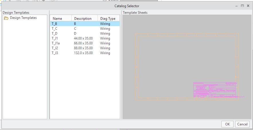

There are several "templates" with Schematics.  There is the base design that is used when you select File -> New and there are design templates that are used when you select Design Explorer -> Create a new sheet.
Now, it appears that there are also the .rsdt files that appear to be used to create new designs based on a standard design.  I am not coversent on the usefulness of the rsdt files.
It appears that you are looking at the design templates from the Catalog Explorer.  You need to have a librarian design (password protected design) to set this up.
Unlock the design (in the Design tab, that is the Schematics 4 name)
Open the Catalog Explorer and thange the Type to Design Templates.
You can add, delete, or edit the Design Templates there.  You can use the Geometry tools to draw your templates and you should be able to import various file types.  Schematics 4 does list medusa files as one that can be imported.
You can then add labels for the text and include parameters.
The first thing we did was to delete the PTC templates and create our own using imported files from our mechanical cad people.
We created all the standard sizes that our mechanical people use except for A (which is useless for our schematics).  We create our designs using a hybrid method that only uses the Wiring type so that are no templates listed for other diagram types.
When you have the process down, go to your base template for your designs and repeat the process.  Don't do anything else in the base template that you do not want to show up in all designs you create.  (don't create a sheet to check the template you just created.  Even if you erase it, your new designs will start with sheet 2)
