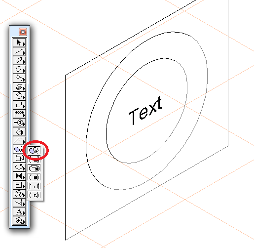

Is there a way to get text to show up on a 2-d plane? The help guide tells you how to put it on a cylinder, donut, sphere. But not on a flat surface.

Sure - it is very easy. Here is an excerpt of the help.
Plane Projection
The plane projection tool (Projection from one plane to another one) allows you to drag selected elements onto another perspective plane.
This function allows you to use existing parts in another perspective. This can be useful, for example, if you want to change a technical view into a perspective view. Furthermore, you can project elements from one perspective into another.

Hi Byron,
Yes if you use the first tool in the dropdown, this will project text onto a flat suface.

Ah I see some of my problem, you need to draw a circle inorder for the projection to work it cannot be a square. How did you get your text to align? Mine is coming in upsdie down and at an angle?

October 9, 2013
Yes, you have to use a circle around the text and snap it to an ellipse on the surface.
In the example above I had to rotate the text 45% using the perspective rotation tool.
You should also be able to perspective reflection tool if it's reversed.
