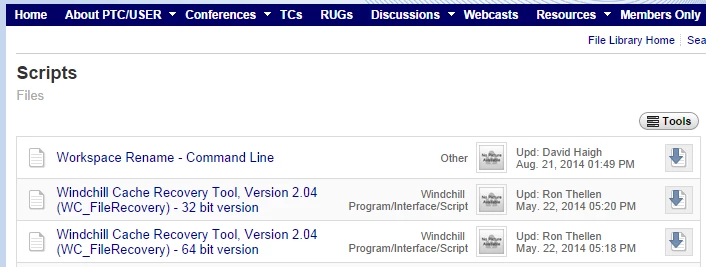

When you log in to the PTC User site, Go to Resources, Library, expand the public files area, (pick "View all Topics"), pick Scripts. The top three items are what you want.
See the attached email for how to use the file I posted. That file was written by Dan Wolf, one of the guys I work with recompiled it after making a minor change.

    Now imagine that the PTC User site no longer exists.
    Thanks for that, but, I didn't ask where to find it at PTC User. I asked how to find it after PTC User gets shuttered. Where PTC Communities stores such things.

    On the PTC Community, there is a documents category where you upload files. They have all kinds of stuff in there. It is very similar to the PTC User upload area.
    October 7, 2014
    To be fair, the CS that links to PTC User's cache recovery tool does have alternate methods of recovery. The other one is "send us your .wf folder and we'll fix you right up". Maybe useful for some, but problematic for others (like myself).
