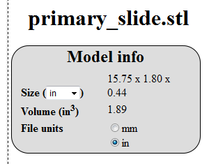

While printing the part, the CAD dimensions change to mm, what is the problem with dimensions? The STL and actual CAD are attached below:

    Still having problem. we loaded the STL in Free online STL viewer. And it says the file has units as mm.
    In Parametric Creo, during saveAs (export) do we need to set any setting to inches somewhere?
    We are using Creo 2.0 and Model Properties -Units is set to inches.

    Free online STL viewer default units is mm. It is not reporting the units of the file. If you want to see values in INCHES, just change Size and Units setting in the viewer.
    This page claims there are no units saved in an STL file.
