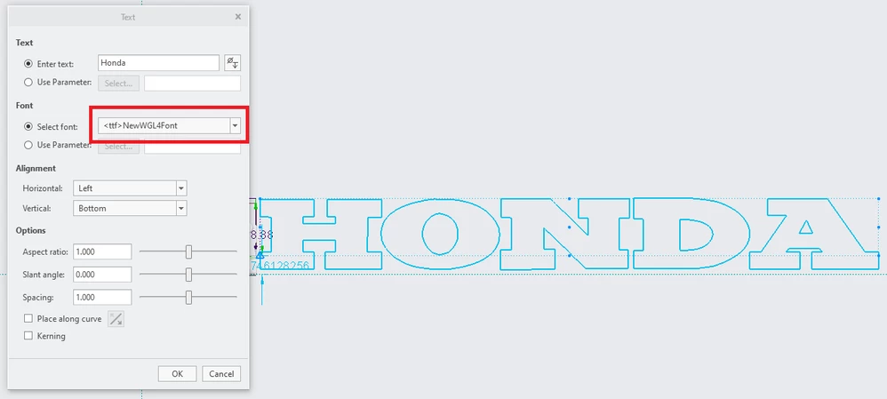

Nov 11, 2023 5:56 PM UTC
  • I downloaded font file from https://fontsgeek.com/fonts/Honda-Regular page
  • I unzipped downloaded honda-regular_CikgX.zip file
  • I copied Honda Regular.ttf to E:\PTC\Creo9_020\Creo 9.0.2.0\Common Files\text\fonts directory
In Creo Parametric 9.0.2.0 I am able to create a sketch feature.
Note: You do not have to install the font into Windows to use it in Creo.

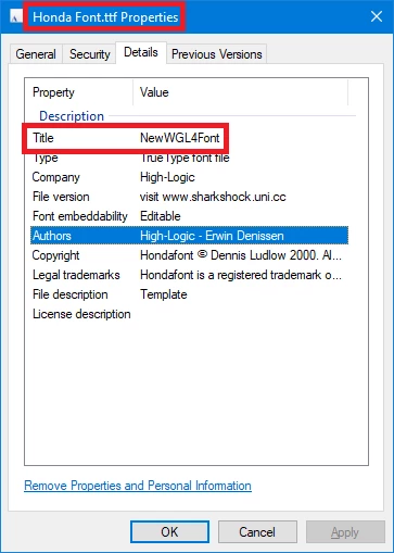

Lecso113-NewcomerAuthor
3-Newcomer
Nov 13, 2023 3:46 PM UTC
You are absolutely right. I was looking for Honda font, not NewWGL4Font in the list. This is the solution.
