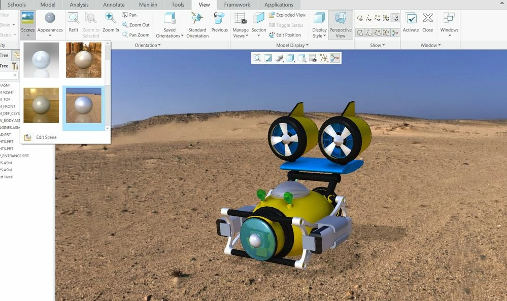

Hello. Long term schools user here since WF3. We've been running Creo 3.0 and now looking to upgrade to Creo 4.0. I've just installed on a trial machine and rendering appears to have been removed from the Schools standard edition. Which version of the license do we need? Is it via the K12 Educators page yet again? Regards James
August 30, 2017
Hi James,
Creo 4.0 Schools Standard doesn't have the Rendering Studio, but now any Creo 4.0 has imbeded a View mode to show the product in the environment:
All you need to do is go to View tab, choose the Scene and activate Perspective View, in the Shading with reflections mode.
Creo 4.0 Schools Premium Standalone/Lab will have Rendering Studio available!
Alex
August 30, 2017
Thanks - the mode you describe isn't really up to the standard I need. I have applied for Schools Premium Standalone licenses. Are they being provided yet? Regards, James.
