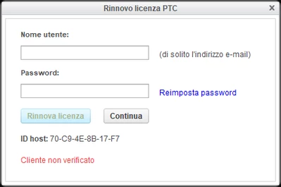

Hi!
my license for Creo Student 6.0 is expiring in a few days. Whenever I try to renew it, it says that my account is not verified.
I tried to rest the password several times, but the problem is always the same: customer not verified.
What could be the problem?
Kind regards,
Jacopo Magnani
cliente non verificato = Not verified customer

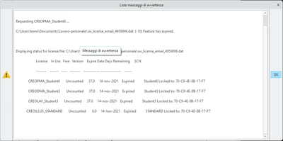

I don't have the ptcsetup file of CREO 6.0.2.0.
This is the screenshot:
Thanks in advance for your kind help.
Jacopo
"PTC Academic Program - Free Download Page": https://support.ptc.com/appserver/auth/it/esd/academicFree.jsp
