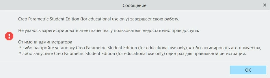

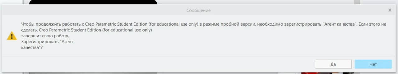

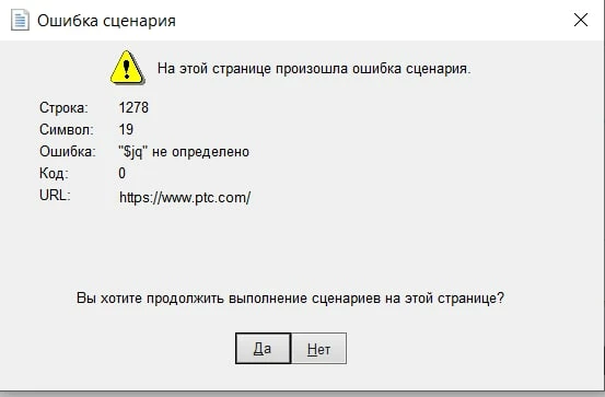

Hello, I can't start Creo, at startup a "script error" window pops up and also that it is necessary to register the "Quality Agent", then the program just closes. Help me please!!!

1.] As for the PTC Quality agent then read on discussion https://community.ptc.com/t5/PTC-Education-Forum/quality-agent-issues/m-p/688821 .
2.] Script error is a warning, only. Ignore it.

Спасибо за ответ, подскажите пожалуйста, а как мне удалить агент качества?
October 12, 2022
uninstall it as any other software.
