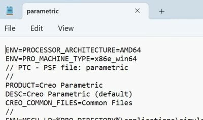

Creo on mac M1 might not be supported however
if you browse to c/program files/ptc/creo/9.x.x.x/parametric/bin/paramaetric.psf
windows 11 is supported from v9
open the file parametric.psf and insert
ENV=PROCESSOR_ARCHITECTUREØAMD64
ENV=PRO_MACHINE_TYPE=x86e_win64
so it looks like this
save file
it will run if you have a legitimate license
