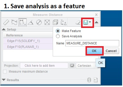

Hi there
I want to set up a relation between one dimension and a result of one measurement. I created a feature measurement but still I could not find out the way to reference it in relations editor... can you help me out?
btw the dimension belongs to one part and the measurement result is from another part in an assembly
Sergio
    Best answer by vmráz
    Process of creating relations with measurement:
    Step1
    Step2
    If the relation is on assembly level, than you need to specify from which part it´s comming from. See Kate Leipold post.
    I hope it will be helpfull

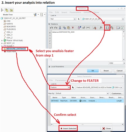

    March 23, 2013
    When you are in the relations IU, use the bracket icon to open the parameter window. From there you can work your way to the measurement parameters. When you highlight the parameter (measurement) you want to use, click the prompt in the lower left. This adds the parameter to the relation window.
    July 3, 2013
    if the measurement is a distance, than you will reference by
    DISTANCE:FID_NAME:0
    NAME is the feature id. 0 is the part number.
    you can also reference measurements such as angle, length, etc.
    These do show up by expanding your local parameters to include current and all sublevels.
    Step1
    Step2
