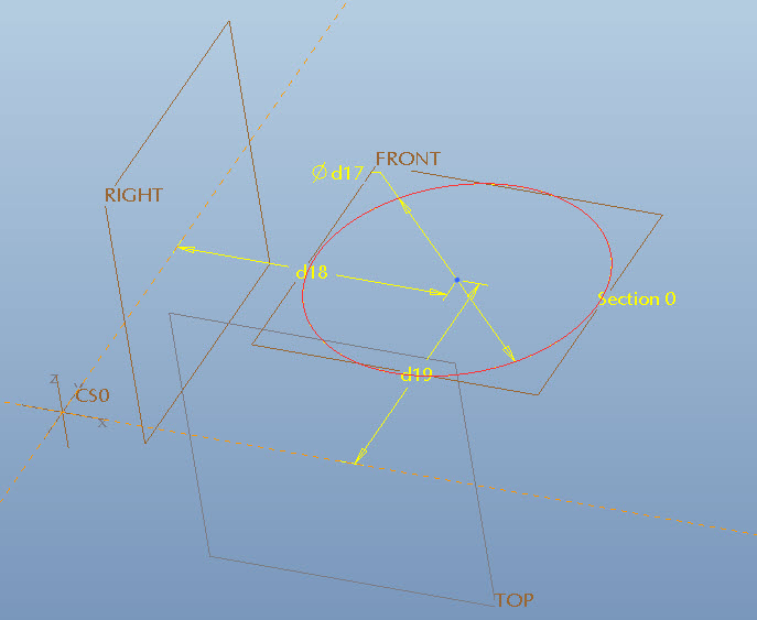

    Mar 19, 2013 8:37 PM UTC
    Hi Elliot,
    I'm having a difficult time understanding what you are trying to express. The figure below is just a sketch on the XY plane. d18 and d19 are completely independant. The circle is on the XY plane, but that can be changed by making a new plane offset from XY. There is a theoretical axis through the center, but you can just as easily create a new axis in that location where the circle is defined as going through it.
    ejenner1-VisitorAuthor
    Mar 19, 2013 9:52 PM UTC
    What figure? i think you forgot the attachment.
    Mar 19, 2013 9:55 PM UTC
    Hmm, sorry about that, it showed up when I posted
