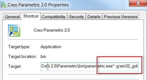

    Jun 18, 2014 2:17 AM UTC
    Simon,
    One more trial for you:
    1. Right Click on Creo shortcut icon on desktop > Select Properties
    2. Move the cursor to end in target path > Add a empty space followed by -g:win32_gdi > Apply > Ok and launch Creo.
    Oct 12, 2019 7:18 AM UTC
    This has solved my problem of launching.
