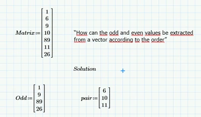

extract odd and even values
Buen día, comunidad. Tengo un problema al extraer los valores pares e impares de un vector en orden. ¿Existe alguna función para realizar esta operación?.

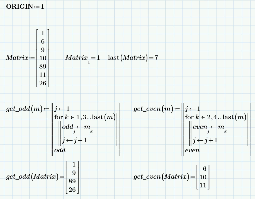

file saved in Mathcad prime 11.0 attached.
Sep 14, 2025 6:55 AM UTC

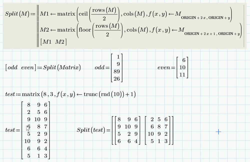

Just stumbled over this thread.
For whatever it may be worth, here is a different way to skin this cat:
The functions can deal with matrices with more than 1 column and works OK with any value you set for ORIGIN. But if ORIGIN is set to an even number like 0 or 2, the first returned matrix contains the rows with even row index (even though I called it "odd". 🙂
