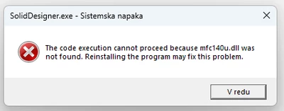

Getting an error message after installing Creo 11 student version
Hello!
@Alex_Cazacu I did as you suggested in this topic. I reinstalled the program, but after starting it, this message appears. It did not ask for an account and password. What should I do?
Nov 2, 2025 9:22 AM UTC
@GregorRožmanec wrote:
Hello! I did as you suggested. I reinstalled the program, but after starting it, this message appears. It did not ask for an account and password. What should I do?
Google ... mfc140u.dll
mfc140u.dll is a dynamic link library file from the Microsoft Visual C++ Redistributable package that is essential for many Windows programs. If this file is missing or corrupted, programs that rely on it will fail to launch. The most common and effective solution is to reinstall the Microsoft Visual C++ 2015-2022 Redistributable package, which you can find by searching for and downloading the correct version from the official Microsoft website.

You can indeed try and install from Microsoft website like suggested by @MartinHanak
I'm a little surprised as when running setup.exe; Creo installer detects when such library is missing.
