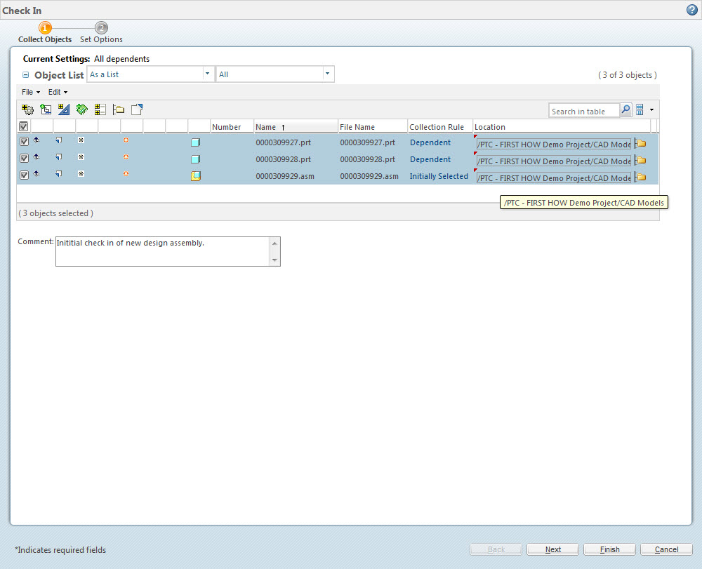

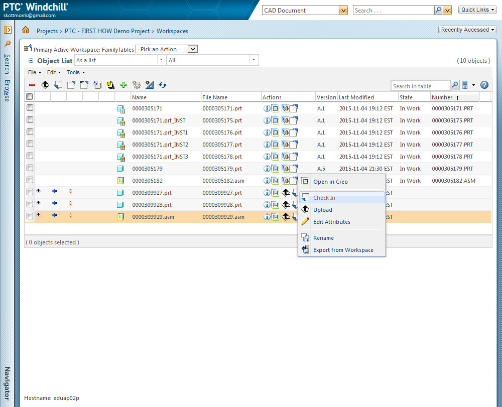

Locate the new items in your local workspace as shown below and initiate a Check In.

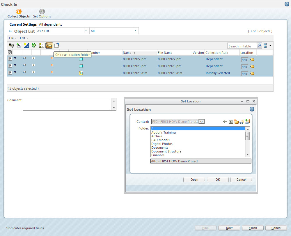

On the Check In page, use the Select All button to check mark all the new CAD files and then pick the Set Location (folder) icon in the toolbar. This will open the Set Location window allowing you to choose any folder in the team project you have access to.
Once the Set Location window is confirmed, you'll see the full path to location of you new CAD files in the Check In window.

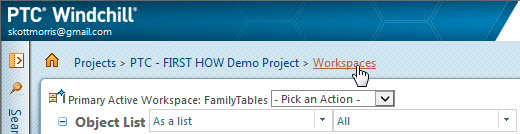

Pick the Workspace link at the top of the Workspace window in the Creo Browser.

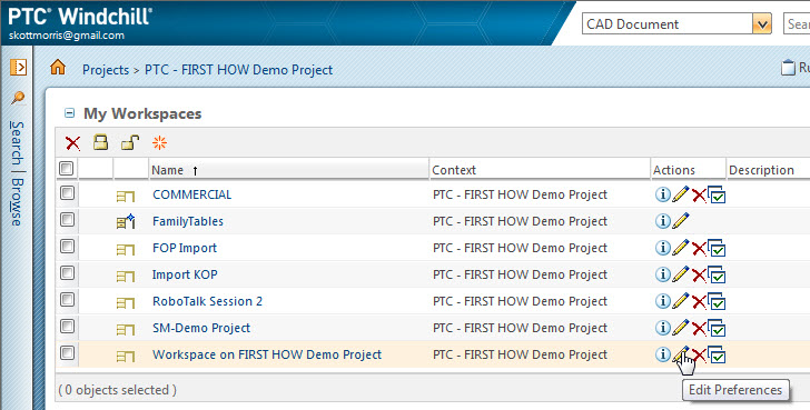

This will bring you to a list of your workspace(s). Just pick the Edit (pencil) button next to the workspace preferences you'd like to change.

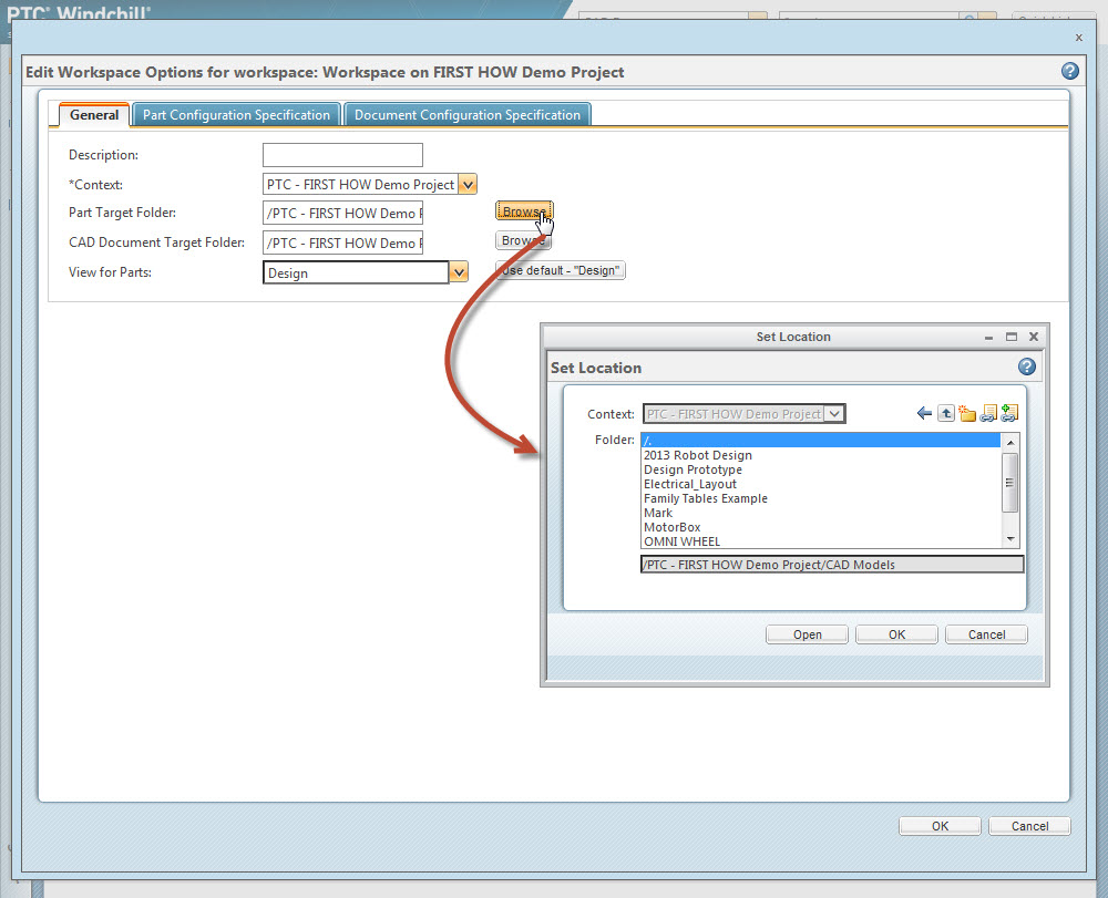

Just like the previous example, you can now set the default folder for all new CAD files using the Set Location (folder) icon.
All that's left is picking OK to confirm the changes and you're good to go. The folder selected here will now be the default folder for all new CAD files created in this workspace.

What is the difference between the "Part target folder" and the "CAD document target folder"? Under what circumstances would you want those to be different?
sm_011-VisitorAuthor
November 19, 2015
The Part Target Folder refers to Windchill Parts that can be associated with the CAD Documents. I do my best to limit the exposure and potential creation of Windchill Parts on the Academic server. Teams are not doing any complex BOM management in their Project and all the advanced capabilities are provided PDMLink compared to ProjectLink. I don't foresee anyone really wanting to manage CAD files and their relationship to Windchill Parts at an academic level with only ProjectLink.
