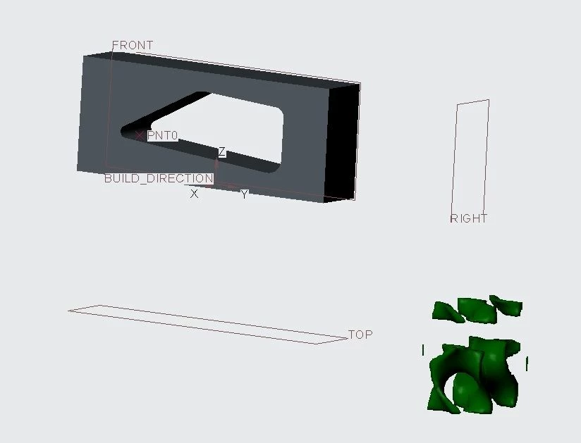

Hello Creo users,
We are trying the new lattice tool and it doesn't work as expected.
Unfortunately we are not able to generate something 😞
The final output ist a minimal surface body deformed and not even attached to the part.
Before:
After:
It does not at all work like in this video here:
https://www.youtube.com/watch?v=m5jNDt2vZqw
Does anyone has an idea why this fails?

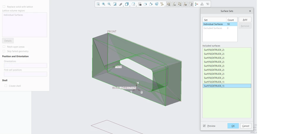

please do following steps:
  • upload your model
  • show what surfaces are selected
  • show lattice size and other numerical parameters
multigrid1-VisitorAuthor
November 4, 2019
thank you for your answer.

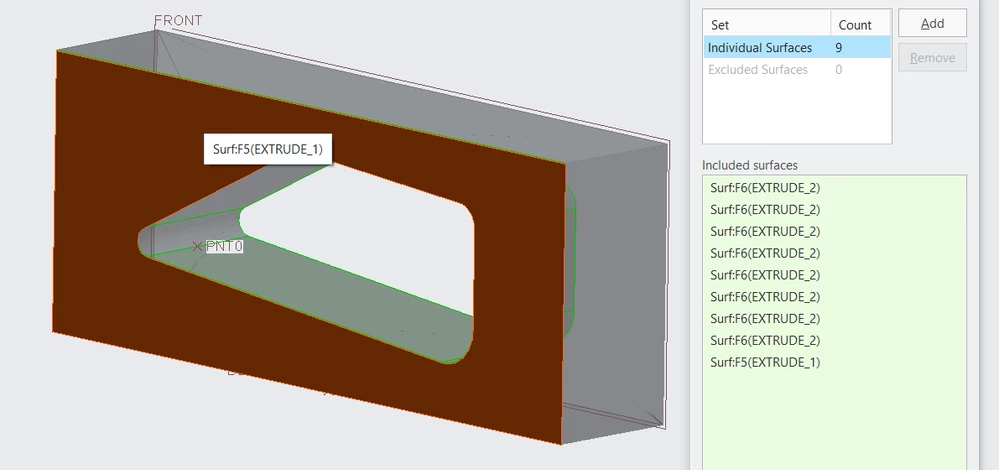

What surfaces do i select:
First I select the inner surfaces like so:
surface_1.pngThen I select the outer surfaces normal to X-direction on both sides (in the picture one of them is highlighted)

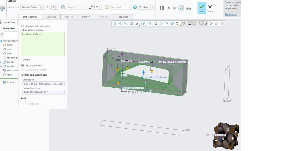

Final it looks like this:

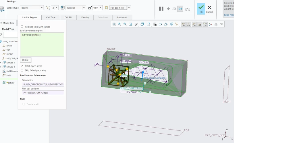

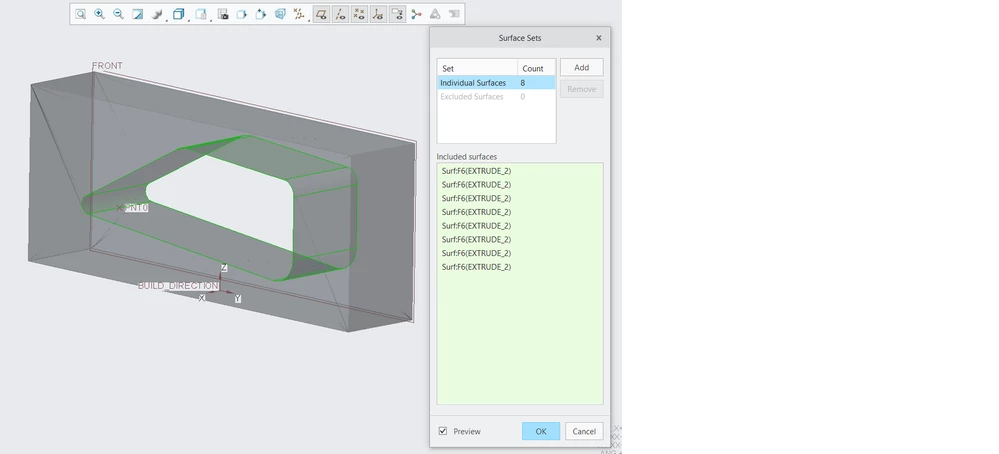

Other lattice types work well with this surface selection.
See here:

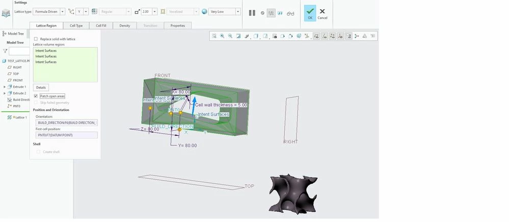

If I switch to e.g. a Gyroid the cell moves to my initial coordinate system regardless of my selection of orientation.

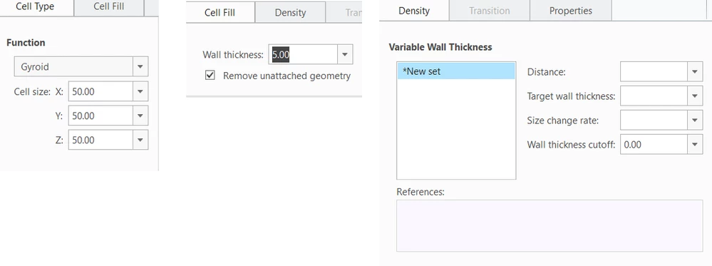

The following parameters are used:
Does anyone have an ideal to overcome this bug?

Hi  multigrid,
The reason you can't generate the lattice is that you are selecting the STL surfaces, as you used the Additive MFG Build tools before the lattice creation. You could try to do the Lattice before selecting the build direction.
Alex
