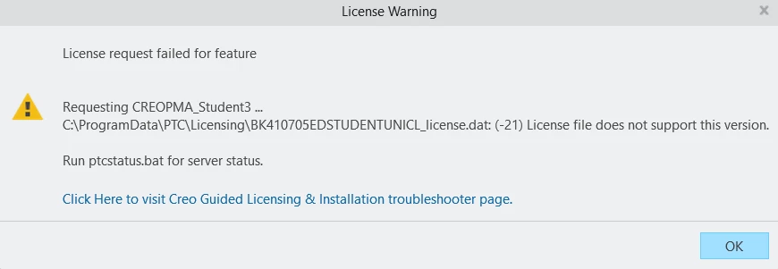

I have a fresh installation of CREO 11.0 with a free university license, every time I open the CREOParametric software I get the following error, and when I click OK the program crashes:
Licence Request Failed for Feature
Requesting CREOPMA_Student3...
Run ptcstatus.bat for server status
Any help is really appreciated 😉

BK410705EDSTUDENTUNICL code belongs to Creo 4.0. BK410705EDSTUDENTUNICL_license.dat contains Creo 4.0 license.
Q: Is there any other file in C:\ProgramData\PTC\Licensing directory?
Q: Did you remove all files from C:\ProgramData\PTC\Licensing directory before starting Creo 11.0 installation?
Please read https://apps.ptc.com/schools/references/install_creo11_unistudent_standard.pdf document carefully.
Exclusive product code for Creo 11.0 installation ... BE110908EDSTUDENTEDK12
