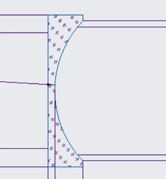

I'm a student and I have a question. Could you please explain how to use the method "ProXsecCompXhatchStyleSet"? I want to change the pattern of the section lines in the perspective view, but I'm not sure how to use this API or how to use other related APIs. Can someone help me?

ProXsec p_xsec;
ProError status;
ProColor warning_color;
ProXsecNewXhatchStyle p_xhatch_style{};
warning_color.method = PRO_COLOR_METHOD_TYPE;
warning_color.value.type = PRO_COLOR_WARNING;
status = ProXsecNewXhatchStyleCreateFromName(L"Wood", warning_color, PRO_XHATCH, &p_xhatch_style);
if (status != PRO_TK_NO_ERROR)
return;
ProXSectionItem* xsec_item_arr;
ProXsecMdlname p_xsecmdlname;
status = ProXsecMdlnameAlloc(xsecMdl, p_xsec.xsec_name, &p_xsecmdlname);
return;
status = ProXSectionItemsCollect(p_xsecmdlname, NULL, &xsec_item_arr);
return;
int n_xsec_items = 0;
status = ProArraySizeGet((ProArray)xsec_item_arr, &n_xsec_items);
for (int ii = 0; ii < n_xsec_items; ii++)
status = ProXSectionItemXhatchStyleSet(xsec_item_arr[ii], item.view, L"Wood", &p_xhatch_style);
status = ProXSectionItemsArrFree((ProXSectionItem**)&xsec_item_arr);
ProXsecRegenerate(&p_xsec);

@XC_14458268  Thank you so much, I was stuck into this finally got it right.
