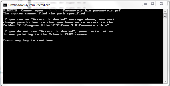

    When I try to configure PLMS4Schools I get the error message below.
    MarkCheli5-Regular MemberAuthor
    October 27, 2014
    Hi Tim,
    We're looking into this now, we should have a quick fix for you shortly.
