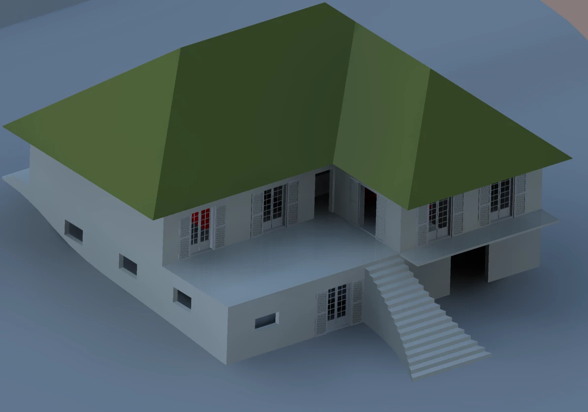

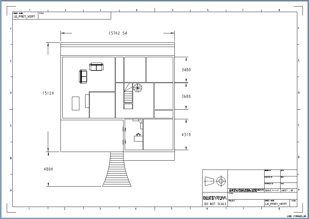

    Although Creo Elements/Pro (formerly Pro|ENGINEER is not commonly used for 2D architectural design it is used for the engineering design of the structures in buildings.
    In schools, using one 3D design package has the added advantages of being familiar to students as they move between projects, easy to install and manage on PCs and networks and re-use of modeling tutorials across disciplines.
    Some time ago I needed to check whether furniture would fit in two rooms so I started to model the rooms in question. Soon I found I had modeled the entire house, the surrounding land, windows. shutters and the furniture in the two rooms! Attached is a very quick 3D render and an equally quick plan view to show what is possible without stretching the imagination too much. I even hinged all the windows and doors to show clearance between them and furniture!
    The things you will miss using Creo Elements/Pro are the libraries of windows, doors, etc. But why not get the students to model these while they are learning the software, accurately modeling objects is a great way to improve skills! Why not use planet PTC to start a file swap thread?

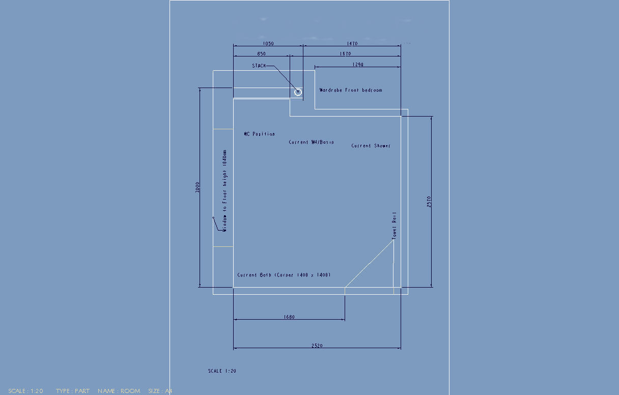

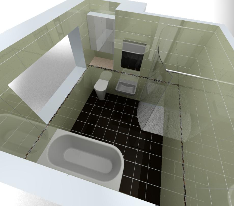

    I haven't used Creo Element/Pro for specifically archtectural drawings but school in my domain have asked me to look at how it can be used in interior design situations. To that end I had a go at redesigning a bathroom and found that it was indeed useful in that situation. Using SE to create the basic room and adding, in the assembly mode, wash hand basin, WC, bath, shower etc., until an eacceptable layout was achieved. I then created the tiles and literally tile the bathroom using assembly techniques. The usefulness of that aspect was the fact that I could determine exactly the number of tiles required and the most efficient layout. Most important of all was the reaction of the 'client' (wife) in that she could see exactly what the room would look like once completed. By generating detail drawings from the assembly file the resultant drawing could be laid oiut as archtectural for use during the refurb. Schools have used this technique to remodel the interior of a caravan.

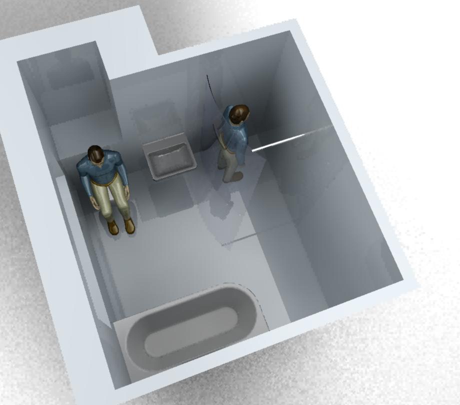

    As an addition I opened the assembly in the University Edition and added the manikin to assess ergonomic elements.
