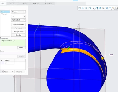

I cannot get the shell feature to work on the extended plenum.  It fails no matter what settings i put in AND Creo locks up for a good long while after I select the rounds to exclude.  The excercise asked for the rounds to be added first, so I assume it was focing that issue.  I also initially left the main housing unshelled, but when this issue arose,  I shelled it seperately in insert mode and it worked FINE.  I tried both single surface removal and both ends like I want.  I am including the model with the failed feature as reference.  Any help is appreciated.

1. When you create a Shell feature, by default the system tries to shell ALL the geometry that is present in the graphics window. This means that the flange geometry with the holes on the front, the mounting flange, the ribs, EVERYTHING is trying to be shelled, The system ends up appearing to "hang" as it tries to do all the computations to solve the geometry. You have to consider the order of how you create things. In your model I suppressed that front flange and holes to eliminate them trying to be shelled, and I created the Shell feature BEFORE the ribs and mounting flange.
2. I would strongly recommend removing the rounds as being part of the sketch for your Revolve and Blend features. This is causing the tangency to be incorrect at the intersection of the Revolve and Blend features, and is causing me to not be able to specify the correct round value at that transition. I've attached the first few features of this model without the rounds so you can see how much easier it is to add the rounds/edit their values after the fact. In an ideal world you want to keep the sketch as simple as possible and leverage the Round feature itself to create the round. Notice also that I held off on creating the flange until AFTER the Shell feature.

Thank you for engaging with the practice at the end of the fundamental courses. I took a quick look at your model and noticed a couple things:
  • You have two shell features, and it is the second shell feature that is currently failing. Remove the second shell feature. You can complete this model with only one shell feature.
  • Move your "Shell 1" feature further down in your Model Tree and edit which surfaces are removed.
However, on your issue about creating the round prior to the shell, this is a result of your internal sketch for "Revolve 1" not matching the drawing. More specifically, the location is incorrect and needs updated. Once it is updated, you will notice the plenum sits further back on the housing which would result in your current "Round 1" extending further back than it does now (see the screenshot of the model in blue for reference).

The top-most Shell was the one I mentioned adding in insert mode to get ANYWHERE at all...the original Shell (now shell 2) just fails whether I select 1 surface or both (the end of the scoop thing and the large round face with bolt holes).
I am not sure I understand about the Rounds...they had no issue themselves and went on just fine, but trying to exclude them from the Shell cause the system to lag, I just thought they could be the reason the Shell is failing?  I tried the Shell both WITH them excluded and WITHOUT.  Below when I moved the sketch, they still acted this way, although to a lesser degree.
"internal sketch for "Revolve 1" not matching the drawing. More specifically, the location is incorrect and needs updated."...ok, hmmm.  I moved the sketch, and the rounds are still valid, but Creo still doesn't allow the Shell, with any combination of selections...single surface, double surface, exclusions, no exclusions.  All fail.  To be clear, I removed the top Shell and moved the sketch as you suggested.

John is correct - the Shell needs to be added further down in the model tree and the plenum is in the wrong location. I've modified your model and re-attached it here to give you some additional guidance.
A couple additional points here:
