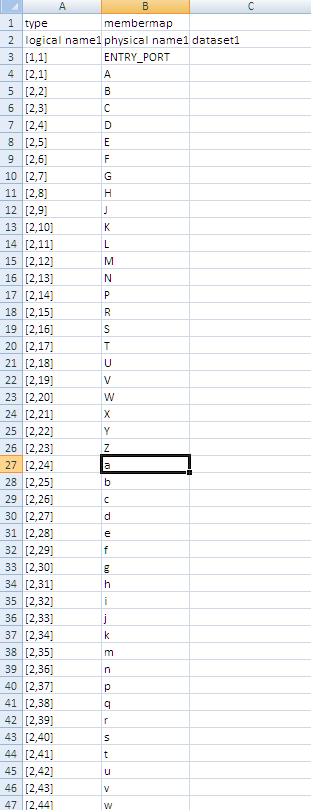

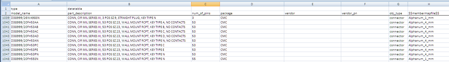

The best way is to use a member map.  See datable and member map images.
jef

It took a bit more fiddling and bumbling than I'd like, but I've managed to start creating and using datatables/membermaps in an effective manner and they provide a much better format, thanks for pointing them out.
