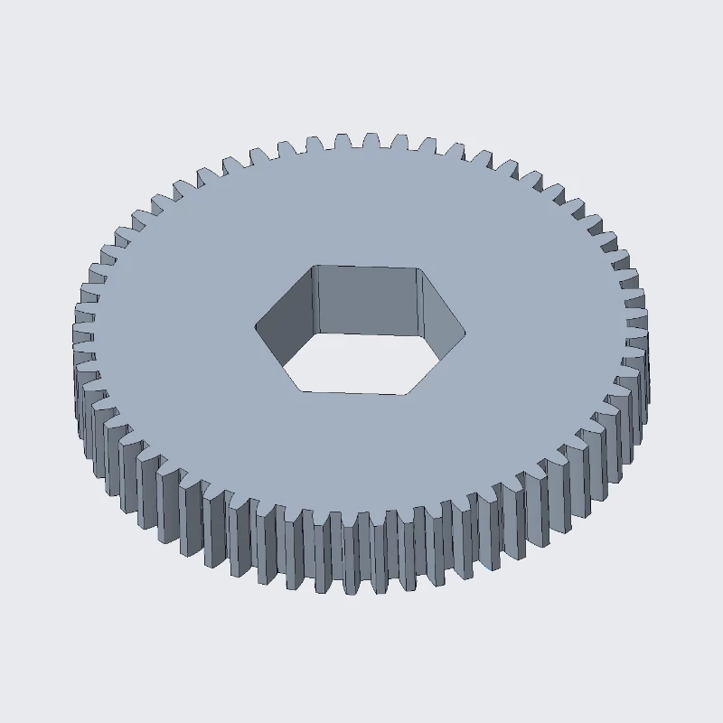

Jun 7, 2018 5:31 PM UTC
I know this is a year old, but I actually managed to do this. Check out my fully parametric spur gear on grabcad. The involute is in a datum curve: https://grabcad.com/library/parametric-involute-spur-gear-generator-1
