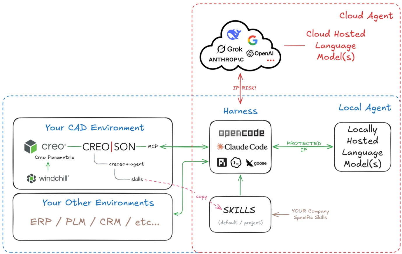

Here is a nice overview of the “how” and the concerns every company should be paying attention to.
This graphic shows a basic framework that every company should be paying attention to for ensuring their their data, transactions, skills, and workflows remain theirs.  This is why Local AI is important and should be a top-priority.  The security angles on this are significant, we are currently focusing on the architecture and guidance to help customers be informed in their choices / decisions.  It is easy to sell a PowerPoint filled with unknown risks - that is not the objective for CREOSON.
The next version of CREOSON will look and feel the same, but enable a new optional pathway(s) via MCP to enable Creo Parametric to better support your business, research, engineering, data management agentic workflows.
