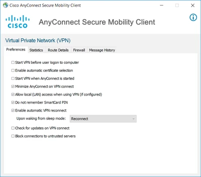

The company offers Cisco AnyConnect VPN for their employees to login to the network (e.g. from home)
However, they wouldn't currently allow AnyConnect to be installed on the workstation in question, probably because that would allow full access to the company's domain by default.
Do you think it would be easy for the company's IP admins to restrict AnyConnect client to only access the license server and nothing else?
May 10, 2021 3:05 PM UTC
Yes, it is possible to restrict the network access.  Is it simple is a question for your network folks.  At a minimum, you'd still need access to "login" servers to authenticate your credentials in addition to access to the license server.
Is the PC your home PC by chance? If so, you may wish to check the licenses associated with your PTC sales order number. With some of the PTC Creo bundles, you are entitled to the Creo Essentials Home Use license which is a node-locked license you can use on your home PC. The files are compatible with the commercial license. You can review the PTC license agreement regarding the home use license restrictions. Please be aware the home use license doesn't include advanced features.  You can transfer files via an external, encrypted, drive easily enough.
