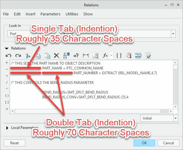

The second revolves around the Edit Relations window.  We do a LOT of relations writing manually, and utilize the TAB button to help us format (indent) our relations  to be a bit easier to read our way through.  I think this started back in Creo 3.0, but it seems like the space that a TAB takes up is closer to 35 spaces in the Relation screen compared to the typical 5-10 character spaces in ANY other program.  Is there a reason PTC has chosen for it to take up this much space?  Is anyone aware of a way to format this to not take up as much space??  It seems like this gets more and more exaggerated every time we do a new update to the tool.  Tab Spacing.jpg

I've never liked using tabs in coding for this exact reason. I do a massive amount of relations editing and to make the indentations more uniform I took the drastic step of switching my font from the proportional  one to a fixed space font. I then use two spaces for each indentation level, etc. I'm not a big fan of the relations editor in general - it doesn't have any of the conveniences of a code editor from the last decade (multiple fonts, context dependent formatting, etc). If you use any other code development tools, by comparison, using the relations editor is like switching from Word to Notepad.

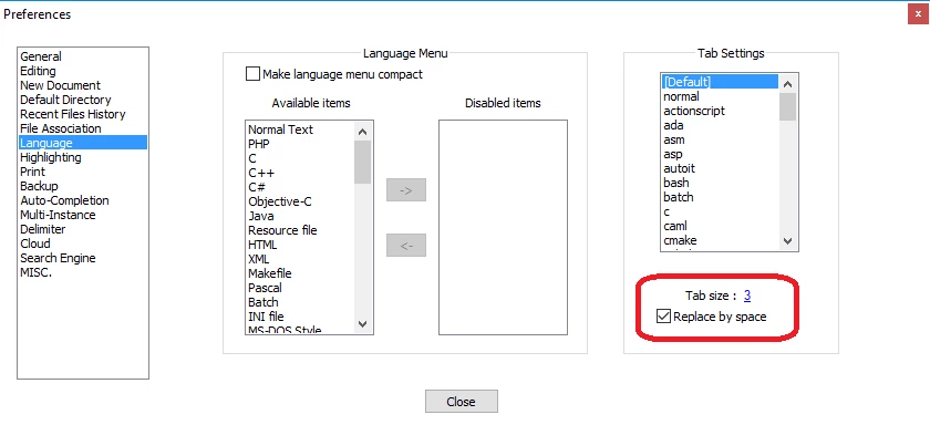

You could use Notepad++  as your editor. In Notepad++ under "Settings"--> "Preferences..." you can change the "Tab size" and check "Replace by space" in the "Language" settings.
