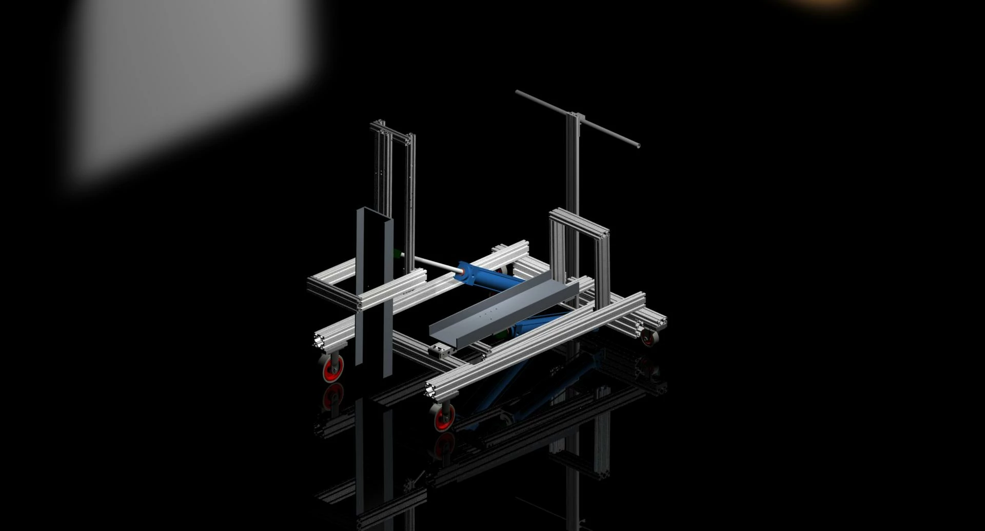

The model can be rendered as a still photo and the animation can be created but when I attempt to render the animation as an MPEG it fails. Creo just closes like it wasnt even there. When I go to file manager and open the "rendered animation" I get a frame or two that look great but that is it. Any ideas as to what is going on.

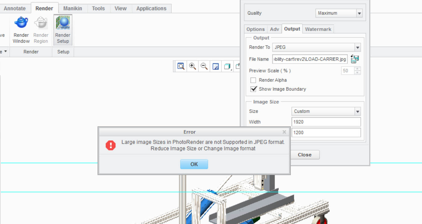

finally complete. It made it through the low quality rendering so I increased the pixel count.... 16 hours later it made it completed without a crash. I think I may have uncovered the problem by accident. While attempting to output a JPEG or BMP rendering to a custom image size I received an error message when trying to make a very high pixel count. With this successful rendered video I set the size equal to what creo calls "HDTV" (1920x1035). It was crashing when I would try to set the video to 1920 x 1200. It seems that with "rendered animations" it is wise to use a default size available from the render setup sub menu..... or this was just a coincidence and it happened to work. Who knows with CREO, lolerror.png

Hard crashes are a serious issue with PTC. I would ask you create a support case and submit your files to see if they can duplicate your issue. As a bonus, you will quickly learn if this is a hardware issue on your end or not.
I have a PTC qualified platform and I am running the Dell graphics drivers rather than the NVidia drivers. If I set the quality of rendered animations high enough, it takes forever but it doesn't crash.
