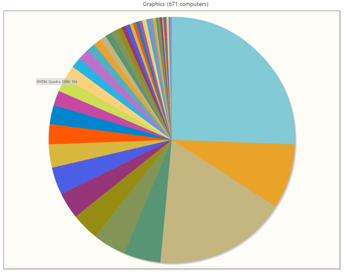

    Hi folks
    On the topic of getting computer specs via command line, for years I've run with this (examples below):
    - Creo startup on each computer uses dxdiag to store the spec
    - These spec files are processed
    - The stats are presented in simple pie charts for graphics, processor, memory, language, etc
    It all runs in the background, you just view the web-pages for the latest charts of specs. Occasionally clear out old specs for computers no longer in use.
    Regards
    Ed
    DxDiag:
    dxdiag /whql:off /t creo~%COMPUTERNAME%.txt
    - copy these to common area
    Process data:
    for /F %%f in ('dir /b creo~*') do (
    find "Card name:" < %%f >>log
    find "Username:" < %%f >>log
    etc...

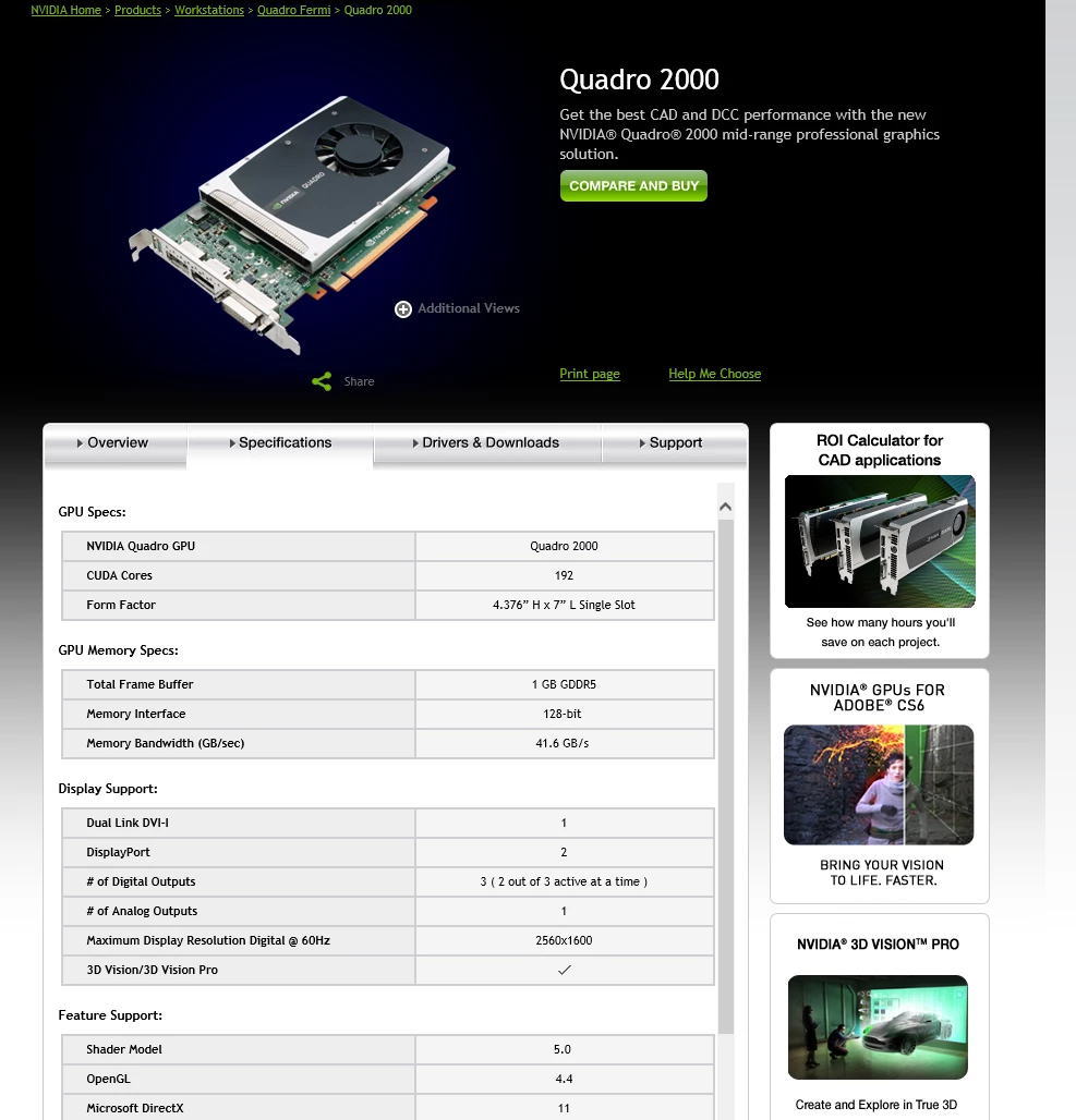

    Jul 25, 2014 2:47 PM UTC
    Anyone have a link that shows a complete list of what Nvidia cards & drivers do support 4.0? A quick search at Nvidia's web site didn't reveal anything.
    My month old laptop with a K3100M is not listed on that doc linked below, but I certainly hope it would support 4.0.
    StephenW
    Jul 25, 2014 2:51 PM UTC
    I searched for my quadro 2000 (about 2 years old) yesterday and in it's specs, it was listed as supporting 4.4
    [cid:image002.png@01CFA7ED.FDB132D0]
    Jul 25, 2014 2:55 PM UTC
    If you navigate under support drivers there is usually additional information in a pdf release notes.
    K3100M is OpenGL 4.4 with driver 340.52
