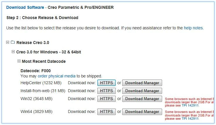

    Jul 28, 2014 7:29 PM UTC
    My first thought is when the heck are they going to put Creo 3.0 on the Software Download web page?
    TomU
    Jul 28, 2014 7:44 PM UTC
    It's there. Been there for a while now.
    Tom U.
