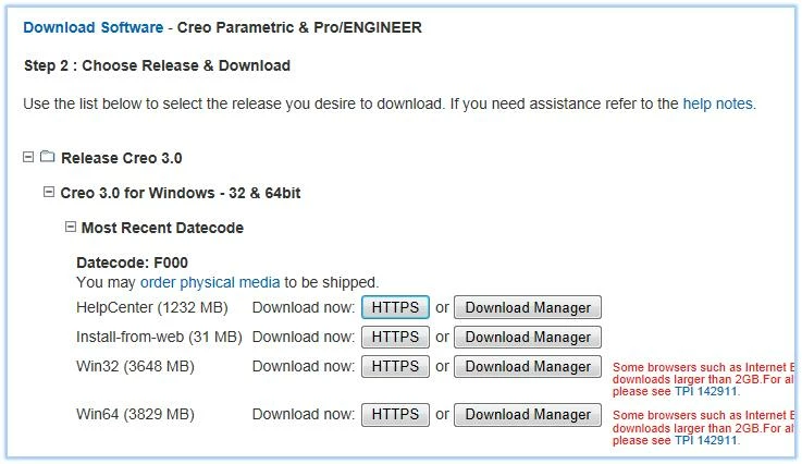

    I sure don't see it. This is all I see and we have maintenance.
    [cid:image003.jpg@01CFAA73.16A70800]
    Jul 28, 2014 7:51 PM UTC
    I had the same problem, you need to log a case with tech support. Not sure why it’s a tech support issue…
    TomU
    Jul 28, 2014 7:55 PM UTC
    Try using the Business Asset Summary Web Tool<">https://support.ptc.com/appserver/lm/bswt/bswt_connect_v.jsp> to review your licenses and see what's on maintenance.
