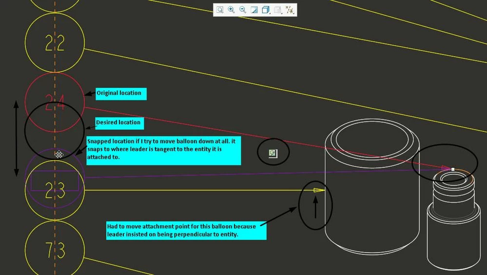

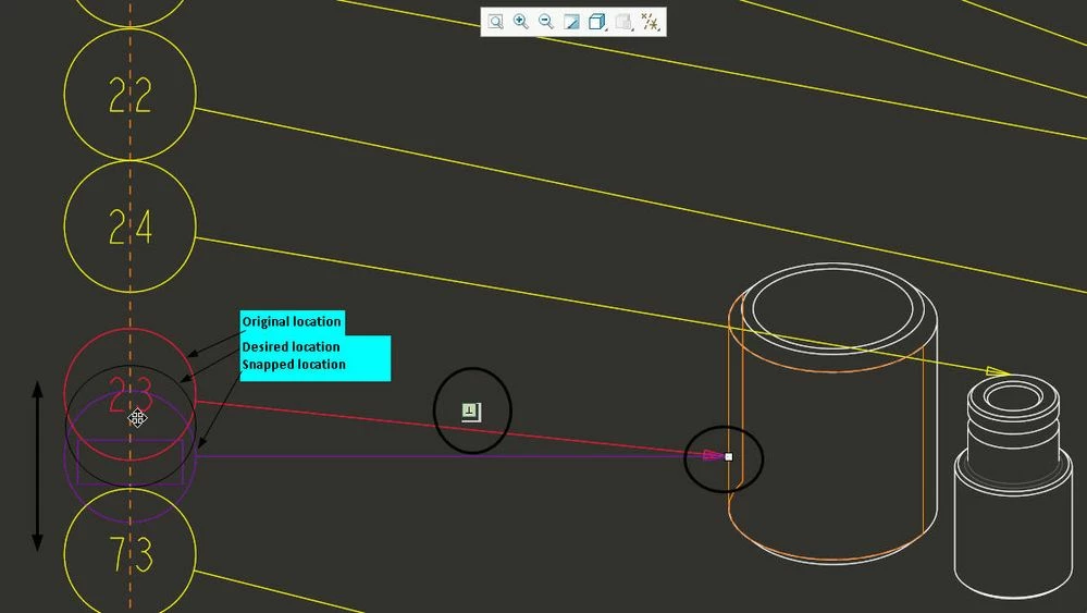

I attached two snapshots.
If I try to move a balloon and it happens to be near a point where the leader line is near tangent to the attached entity, or perpendicular (normal) to it, it snaps to where it would be tangent or perpendicular to it.
There is no way to disable this that I am aware of. I would think you could right click to disable the automatic snapping constraint, like you can when you are in sketcher mode creating a feature, but this does not work. Just the same, disabling the constraints activated for sketcher does not effect this behavior.

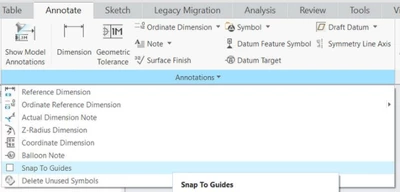

Oct 13, 2020 11:26 PM UTC
kdirth
Oct 16, 2020 12:11 PM UTC
If you follow the link in my previous post, at the bottom is instructions on the fix implemented in 4.0 M130.
The simplest is to turn it off by deselecting Snap To Guides.
