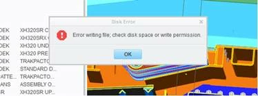

    We have gone through a couple of build codes...m050 and m090.
    We have experienced a couple of repeat offenders...first one is highlighted below.
    [cid:image002.jpg@01CF3DD9.55C5AED0]
    This appears to be random...it has nothing to do with too little disk space or the users' permissions, it seems to be related to the actual models.
    The second is when Creo crashes after getting the following error message
    [cid:image004.jpg@01CF3DD9.55C5AED0]
    Again it appears to be random, can occur when either working in a drawing or an assembly.
    In both cases PTC told that us m080 would resolve but we have still had both occurrences with m090.

    March 13, 2014
    Thank Gavin
    No unfortunately ours is not the same as you describe.
    It has been random but on a couple of occasions it has happened the user said that they had first created a new sub-assembly whilst working in a top level assembly and then created a part in that sub assembly. The error comes up when they then open the part or sub-assembly in their own window and try to carry out a Creo save.
    One thing we are trying to determine is if it is a Windows problem, i.e. too many files in the working directory. Our users can have typically tens of thousands of files in their working directory.
