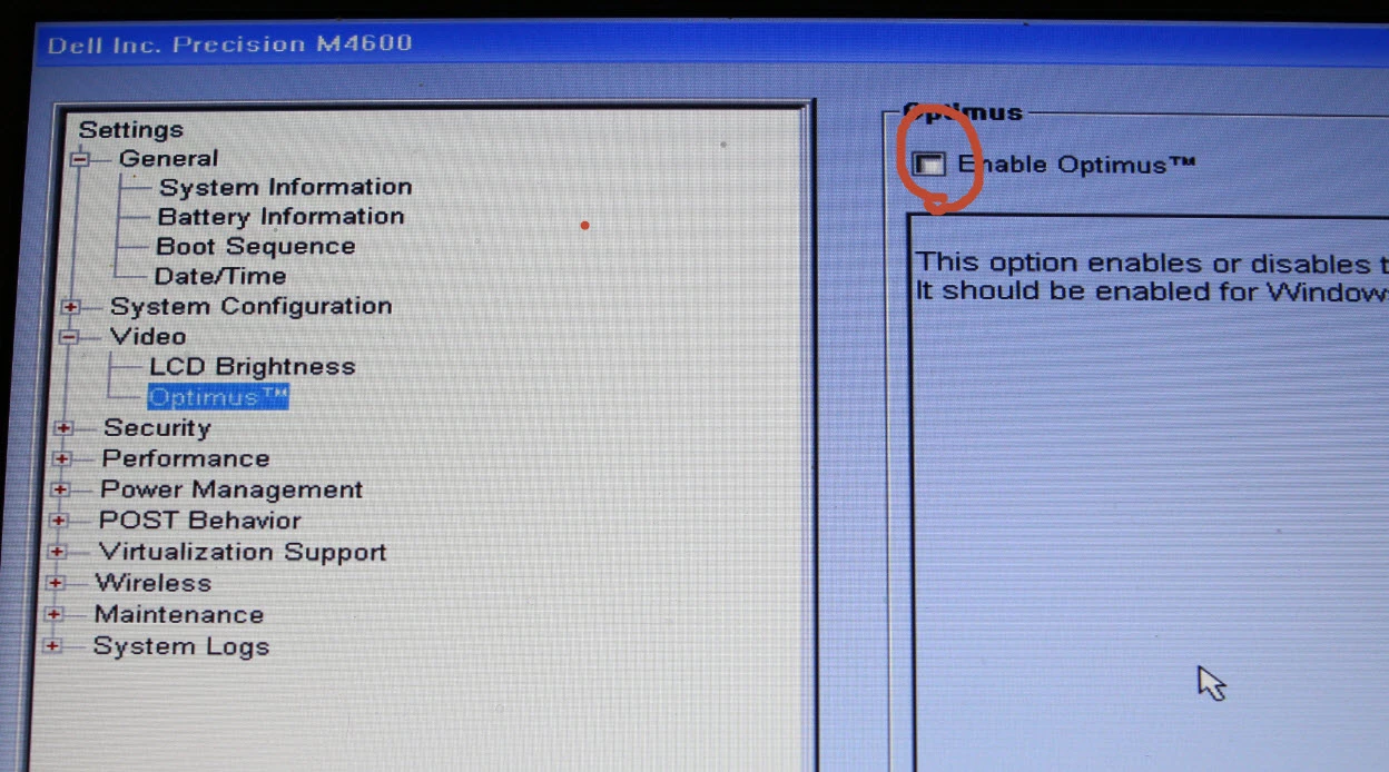

Creo M090 don't start
Hi
running Creo on a Dell M4600, and after updating to datecode M090 Creo will not
start unless my computer is in a docking station and have 1 or 2 screens attached!

    Do you have an integrated graphics card? M090 has a problem with that. You either have to wait for M100 (Supposedly it's fixed) or go back to a previous build.

    Or if you have another graphics card other than the integrated graphics you can make that one your default graphics card for Creo.

    Problem solved 🙂
    The problem was the two graphics cards, you
    need to change some settings in the Bios
    Solution
    for me
    F12 when the Dell logo coms on during startup - Bios - System setup - Settings - Video - Optimus - Remove tic at Enable Optimus se attatche pic for "screen dump"
