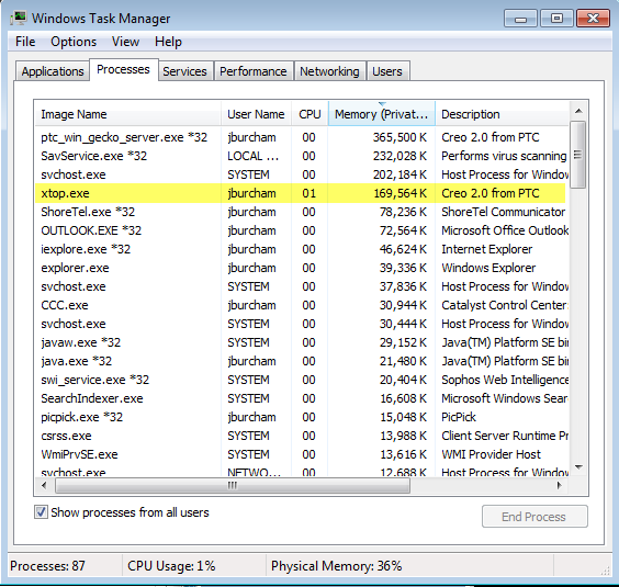

I am have a weird issue with my Creo memory usage. I am using Creo 2.0 M040 with Windchill 10.1. When I start Creo my typical memory ussage is around 160,000k, as shown in the task manager(see image). As I continue to use Creo the memory usage continues to grow. Even after I complete and end tasks this memory never decreases. It will grow to over 6 million, as it grows Creo and Windchill continue to get slower and slower before eventually just stalling.
Has anyone seen this before, and do you know how to fix it?

Are you performing an Erase Not Displayed after you close all your windows?Remember, Creo retains all opened files in session (memory) until explicitly told to get rid of them.

Managing memory can be done by using "erase not displayed" assuming you are loading a different model or simplified rep in your Creo Parametric session. Another alternative approach to this problem, if you need the models retained in session is to add more RAM.

Generally that's a memory leak. I have it where I have to close/open Creo every day or 2. And if I use a really large amount of memory (I'm only running 8 gig at the moment). then I have to reboot to "fix" it.

Yes I am "erasing not displayed", every time I finish working with a model.
Matt, I am also running 8 gigs or RAM, and I have to restart Creo everyday, and my computer every couple of days. It sounds like you might be having the same issue I am.
September 18, 2013
Yes I even have erase not displayed on a one click macro, because I don't care to see what's being erased. I just hit it and move on to the next working directory.
Mine doesn't keep building the way you described though. Or at least not what I think you are describing. When I "erase" it still has about 1 gig of memory and then closing Creo releases it. But I have never seen it retain 4-6 gig.

Our CAD Department just said me that the problem is due to Windchill, non proE/Creo.
The only one method is to shut down proE.
