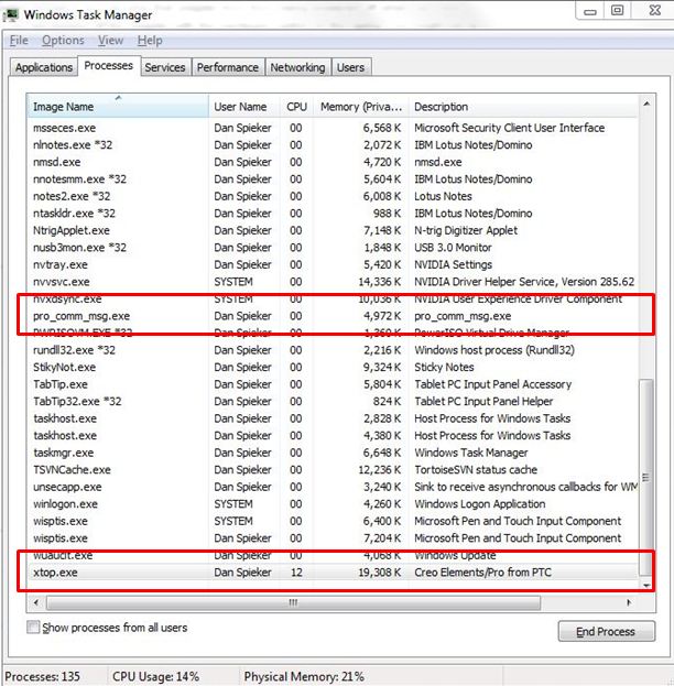

Creo suddenly refuses to start
Early today (and the last several weeks) I've been using Creo M090. Suddenly it refused to load. I see the pro_comm_msg.exe process start followed by xtop.exe. The xtop.exe process looks like it is consuming on of my CPUs, but nothing is ever displayed and memory usage is not growing.

Apr 26, 2012 4:57 PM UTC
Here is a view of task manager after I try to start Creo. This view doesn't change, xtop.exe stuck at 12-13% CPU and memory usage remains constant.

May 3, 2012 6:48 PM UTC
So I think I'm on to something in case anyone else runs into this...
I have a Dell M6600 laptop. It has a Quadro 5010M and also the Intel internal graphics card. When the "Optimus" technology is turned on in the BIOS to enable both graphics cards to drive several monitors, ProE/Creo will not start. One of my co-workers also had this problem with SolidWorks. So I have to turn this off when undocked, and turn back on when docked.
Not the best solution but it does work.
