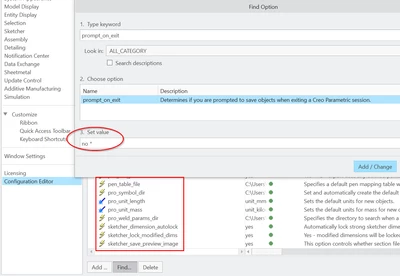

Dec 7, 2022 6:42 AM UTC
I already have the default no* value (see image), so obviously something is wrong.
However, that is an interesting option (if it worked...), as that would leave you without any Save control at all.
Dec 7, 2022 7:34 AM UTC
I think you misunderstood Ben. The prompt_on_exit option has "no" as default value which means you won't be prompted to save unsaved changes to models in session, so it's nothing wrong here. You need to change the value to "yes" and then Creo will prompt you to save every modified (and unsaved) model before closing the Creo session.
