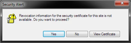

    Solution.
    The user this morning kept trying the server management window and suddenly got this error.
    [cid:image005.png@01CEFCCA.C9332A50]
    Fixing this in IE solved the problem. Still trying to find out what happened to the certificate.

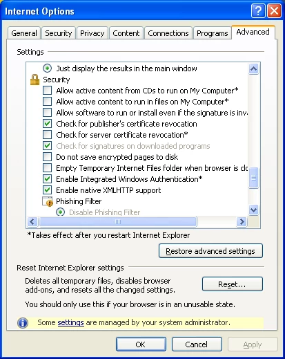

    From I.E
    1. Go to Tools --> Internet Options -Advanced
    2. Under the Secuirty category de-select "Check for server certificate revocation*" . This prevent any dialog popups that can be prompted due to this setting.
    [cid:image003.png@01CEFD63.936A2600][cid:image002.png@01CB95E1.620F6F30]
