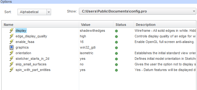

usually the problem is related to graphic card. Try to add following option at the and of config.pro file.
graphics  win32_gdi

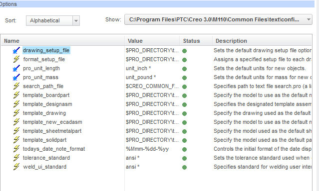

Helloo,
Thank you for your answer, but I don't know how to do the modification for config.pro.
I didn't find the file.

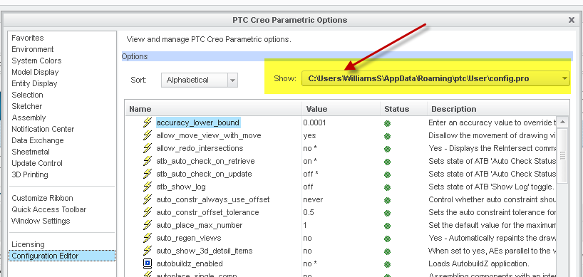

StephenW
May 24, 2017
Go to FILE - OPTIONS then configuration editor tab. On the top, this will show you where your config.pro file is. It is simply a text file.
Once you find the file, simply used notepad (or other non-formatting text editor) to add the line to it and then re-open Creo.
alouraiga1-VisitorAuthor
May 24, 2017
I did't for the first one.
But for the second one they told me access denied.
StephenW
May 24, 2017
You only need to add it to one config file.
When you restart Creo, is the performance improved?
If so, this means you have a video card issue, You may want to try the latest video card drivers (remove the line from the config.pro file to test the new drivers).
