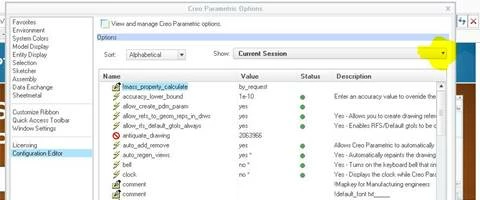

Also check to make sure your are not having these setting overwritten by your config.sup file or another local config.pro.
You may want to also maybe put a final backslash after the full path as such (I have had issues sometimes with or without the last backslash):
(start_model_dir C:\Creo 2.0\Common Files\M090\pro_std\Templates\)
And go into your config area and look at the “current session” from the dropdown to verify that one is pointing in the correct folder.
