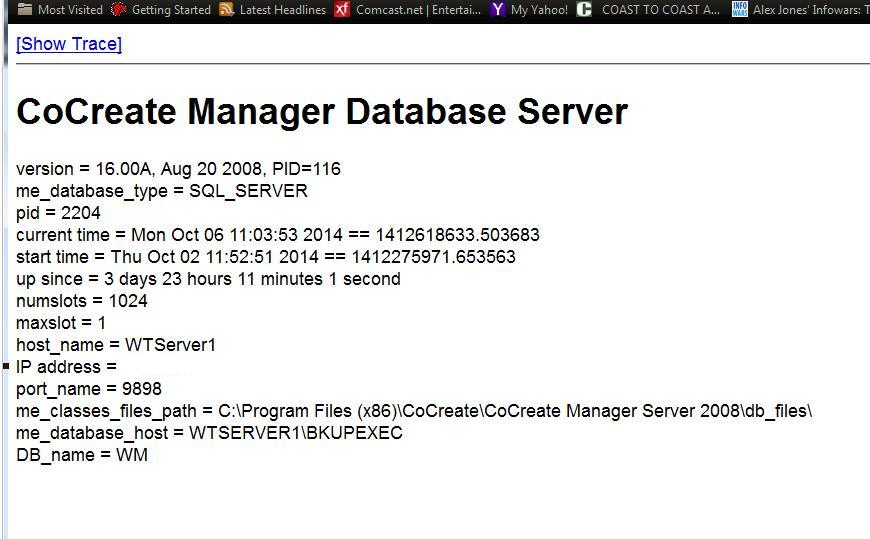

This just started a day ago. We have been using this program and system for 5+ years with no problem. Error message that the engineers are getting when they try to start up the Model Manager. "could not connect to database server: (name of our server) The error code at the bottom of the detailed summary is. Error Messages = 10002 - ***ERROR: Failure in communication to server. As far as we know we have not made any changes other than Microsoft updates which we have backed out the latest ones, which did not fix this issue. Any help here? we do not have a service contract at this time.

Is this happening to all users?
Type this into your internet broswers address field: "Model Manager Server Name":9898.
Replace "Model Manager Server Name" with the actual name of your server. (No double quotes)
Do you get a status page showing the database condition?

Well we get the server information. This page only stays active for about 30 sec then it bombs out.
( I removed IP from this image)

I am writing this to give an update on our problem. First I would like to thank all who gave feed back. We are still not able to use Workmanager. It seems that our contract server support removed our SQL software when performing a backup. This destroyed any links to our database. We re-installed the software but this had no effect getting to the data. When contacting PTC they would not talk to us or our support people at all, would not even give advise until we purchased a maintenance contract. Then after purchase of this contract 8K, we find out that no one in this country knows how to work with this older version data base so we are connected to Germany (different time zone) for help. This discussion is still ongoing for about a week now. Hopefully this will eventually work out but the point is we could not purchase just support we had to purchase a full contract that will get us updated but we are not sure if our data is going to port from version 16 SQL base to19 JAVA base if we ever get it back at all.

The most important question is:
Is the WM Database still there? (hopefully).
For a database of type SQL Server, the Database is located under (e.g)
C:\Program Files (x86)\Microsoft SQL Server\MSSQL11.SQLEXPRESS\MSSQL\DATA
The database consists of (just) two files:
WM.mdf
WM_log.mdf
(if your database is "WM" which is the case).
If these files exist, your database still exists - and you should copy the files to a safe location
before you try to install any software.
If the database files are gone - your database is gone - but you still have all the Files from Workmanager
in your File Server Storage Area - which is completely separated from the Meta Data (=the database).
