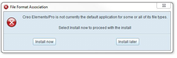

File Format Association Error
Recently I have this popping up when ever I start WF5/Creo. Any suggestion as to what it is asking me to install?
Thanks, Dale

Oct 6, 2015 2:27 PM UTC
Dale,
I think the best way how to solve the problem is to deinstall/install WF5...
MH
Dale_Rosema
Oct 6, 2015 2:29 PM UTC
Martin,
WF5/Creo is the main software we use. I had Creo3 loaded in a different directory..... so I could do some trial evals.
Oct 6, 2015 2:35 PM UTC
Dale,
if you use different ProE/Creo version, then it is necessary to set PTC_WF_ROOT variable for every version. I do it in psf file in bin directory using the following line:
ENV=PTC_WF_ROOT=path_to_directory_related_to_specific_version
MH
Mahesh_Sharma
22-Sapphire I
Oct 6, 2015 3:51 PM UTC
Dale,
You may wanna try repairing the Productview by executing ProductView_Express_32_64.msi from Creo Elements Load Point\install\addon.
Dale_Rosema
Oct 6, 2015 3:53 PM UTC
Forgive my ignorance, but for what is productview_express_32_54.msi used?
Thanks, Dale
Mahesh_Sharma
22-Sapphire I
Oct 6, 2015 3:55 PM UTC
It is for ProductView Express installation/reconfiguration.
Dale_Rosema
Dale_Rosema23-Emerald IVAuthorAnswer
Oct 15, 2015 3:56 PM UTC
From my VAR - we set the config.pro:
startup_check_for_visualization - no
This is a work around that solve the window popping up.
Thanks, Dale
