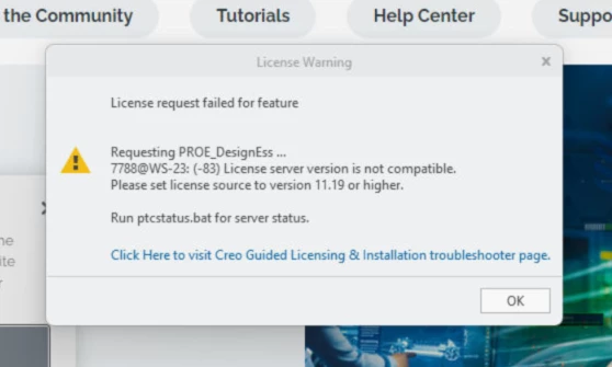

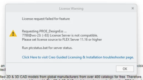

FlexNet Version Error

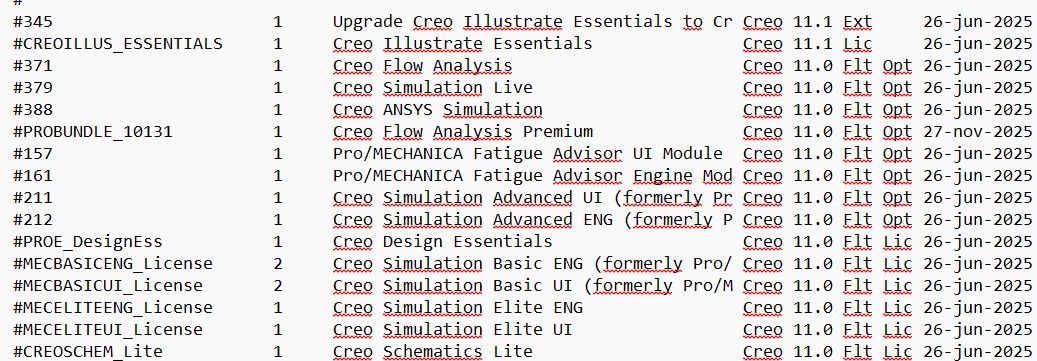

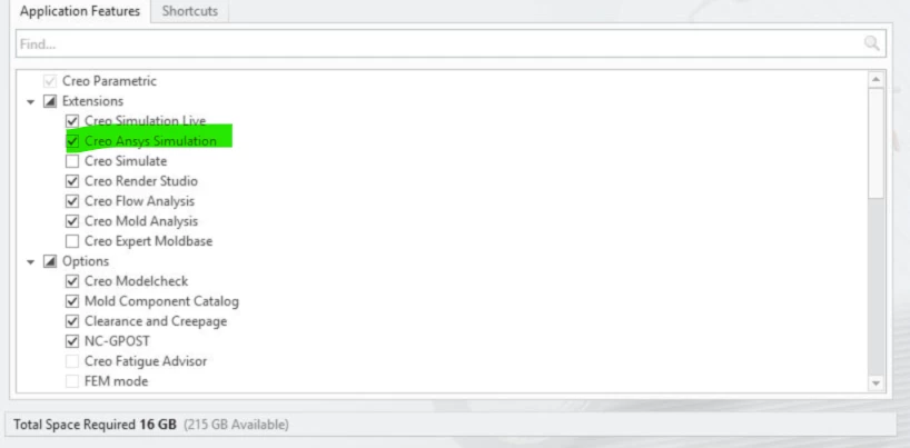

I'm installing CREO 10.0.6.0 to use CREO Anysys Simulation, when I start it gives a flexnet version error, I've tried all possible versions and I can't get it to work, the license is for CREO 11, as shown in the print

What I see is that you have licenses that are valid for Creo 11, which is good if you're trying to install Creo 10.
What the error messages are telling you is your FlexNet installation on your server is not of a high enough version to be used with the software you are trying to use. You or your network administrator need to update the FlexNet license server to a version that is compatible, apparently at least 11.19.

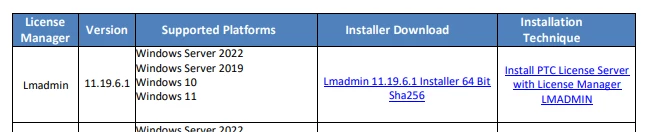

I did a quick check and for Creo 10.0.6 the download area tells you:
Creo 10.0.6.0 is packaged with the PTC License Server powered by FlexNet Publisher 11.19.6.1. For VERY IMPORTANT information, refer to CS413906
So if you take care of things to comply with this requirement, you should be okay.
MS_Santos15-MoonstoneAuthor
February 25, 2025
So I went to the PTC website and downloaded this version for flexnet, but I still got the same error, my machine is windows 11Flenet baixar .png
