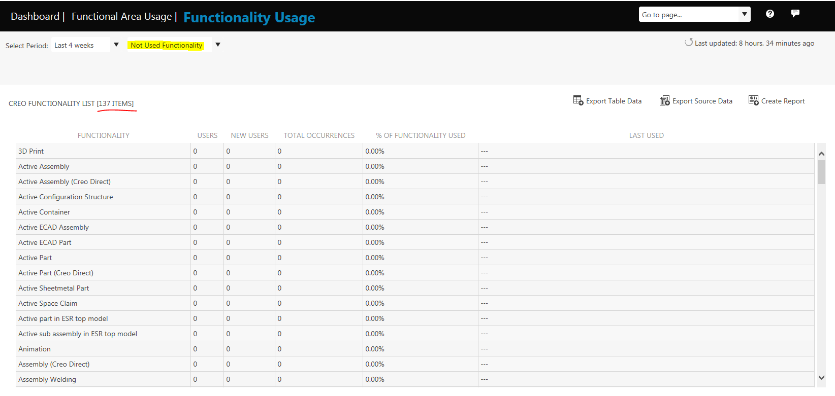

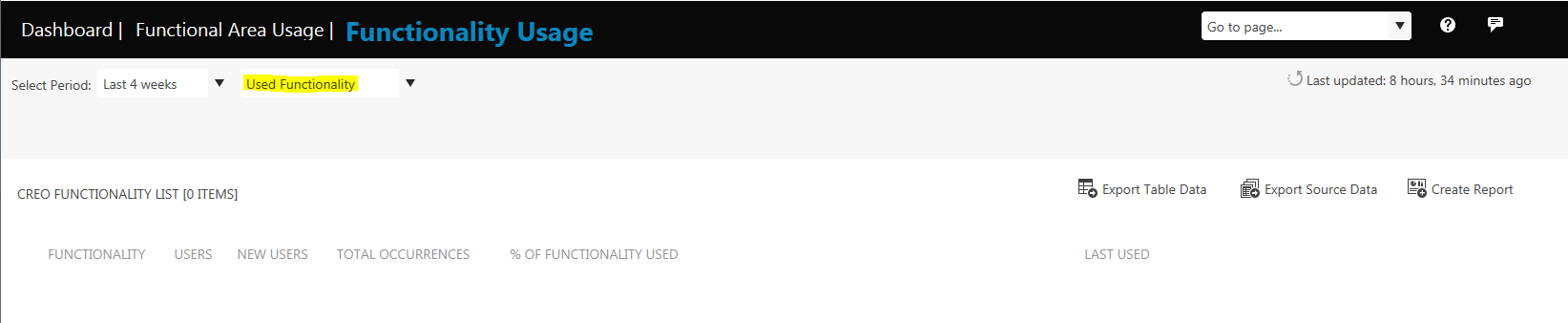

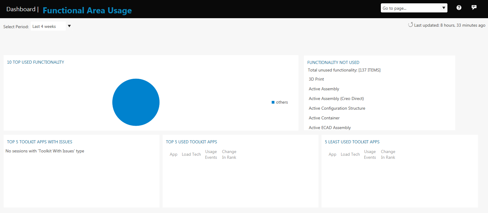

Dan‌, I have a couple of questions.
1.)  I see the dashboard, and all of our systems are configured to send data to PTC, but everything is showing zeros.  Is there something that needs to happen to turn on this tracking?  (We are running Creo 3.0 M090 & M100)
2.)  You said in your video that only the owned functionality will be displayed.  I'm seeing many functions that we don't own (options modeler, mold, mfg, etc.)  Any idea why?

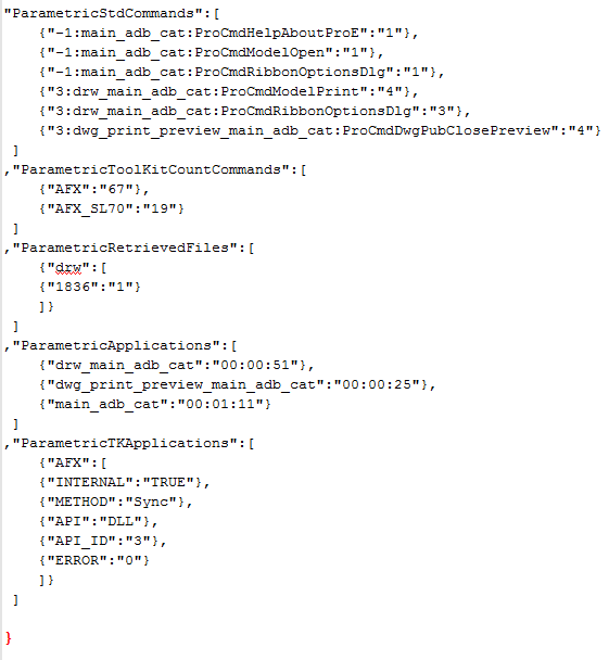

1) Your builds of Creo 3.0 are certainly compatible with this functionality (Creo 2.0 M220+ / Creo 3.0 M090+) - Can you check the zip files in the quality agent sentfiles folder at "\AppData\Local\PTC\QualityAgent\SentFiles"? You are looking for files named "featureTracking.....json". If they are indeed being sent, we need a deeper investigation with a TSE, which i can help start.

July 8, 2016
Here's what I see:
By the way, I just listened again and he said, "you can also review functionality that you do own but is not currently being used".
TomU
July 8, 2016
Dan, Thanks for the reply.
I was wrong about the builds.  Most of our users are still on M080 and the .json file isn't present in their sent data.  On the other hand, I have been running M100 since July 1st (8 days) and all of those .zip file DO include the feature tracking .json files.
Here is the "guts" of one of them (minus the UUID):
Does a certain period of time have to pass (more than 8 days) before reporting becomes available?  (I'm hoping not 4 weeks...)
