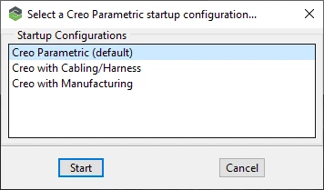

We've got a few different floating licenses for other modules. Most of the time people don't need them, i.e. I'm just doing modeling, so I don't need the Machining Module. So, when I set up Creo on my machine, I generated different .psf files (and .bat files) from the setup utility. For my version of the program these are stored in
C:\Program Files\PTC\Creo 4.0\M120\Parametric\bin
As a result, when I start up Creo, I get the menu of selections as shown in the attached image. The same should be true for the floating/locked licenses, I would think.

KenFarley
July 28, 2021
I have one icon that, when I use it, brings up the menu I showed in the screenshot. When I look at its properties, the Start in: is
"C:\Program Files\PTC\Creo 4.0\M120\Parametric\bin\parametric.exe"
It seems that parametric.exe looks in the same directory and if there's more than one .psf/.bat file duo in there, gives the user a menu as is shown. It's nice and convenient and prevents people grabbing a license they don't need.
